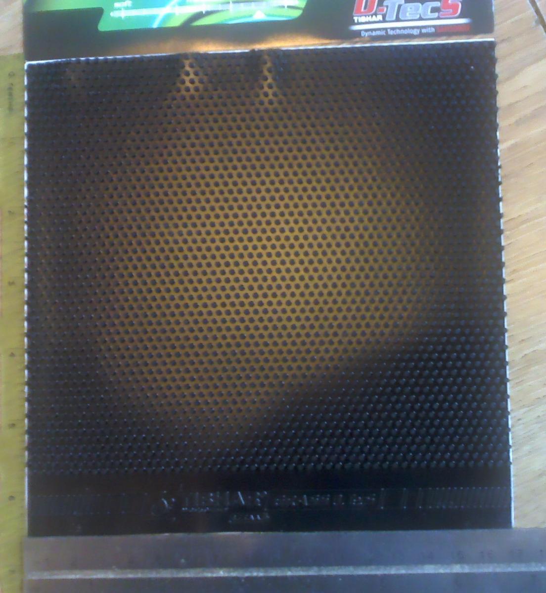

hebel_st, thanks for the clear picture. here is one of a new sheet of DTec.S to compare.
I counted the number of rows and number of pips per row. Both have pip filled areas of 17 cm x 14.8 cm
FS = 62 horizontal x 47 vertical = 2914 pips
DTec.S = 52 horizontal x 52 vertical = 2704 pips
Again, apologies for posting in English...
