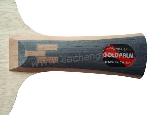

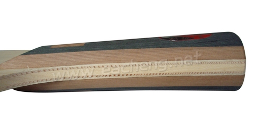

I found some additional pictures at eacheng. From those pictures I would guess that outer plies are limba and medial plies are something like spruce or fir. Probably Ayous or Basswood as core. In fact that composition looks very similar to Victas Koji Matsushita's composition (which I'm playing at the moment and which is great for modern defence), so I am very interested in trying it... Think I'm going to order one. Besides, it's a Chinese price.

Danke, bamboole! I'm worried about "Zumindest für kleine Hände top"... Was it the straight (gerade) handle? I suppose you mean the handle is rather "thin"? I don't like thin handles (f.e Yinhe Schild) at all :-(
Weight is no problem for me. Strange that spinfactory mentions that size is 157x157. The original size is supposed to be 157x162 (double-checked it with ttnb).
BTW, Coxeroni: it is Palio Chopper (not chop, another mistake at Spinfactory...). See http://www.palio.co/en/palio/pblade/woo ... 8F%B7.html. From that picture, outer plies could as well be Koto (striated pattern) which would make the blade much harder.
Bamboole, I'm still curious to hear from you whether you think it was a "thin" straight handle. At ttnb, I've been told that dimensions are 31x23 which sounds thicker than the average, but I have more confidence in a user's perception than in such a measurement (often done roughly)
