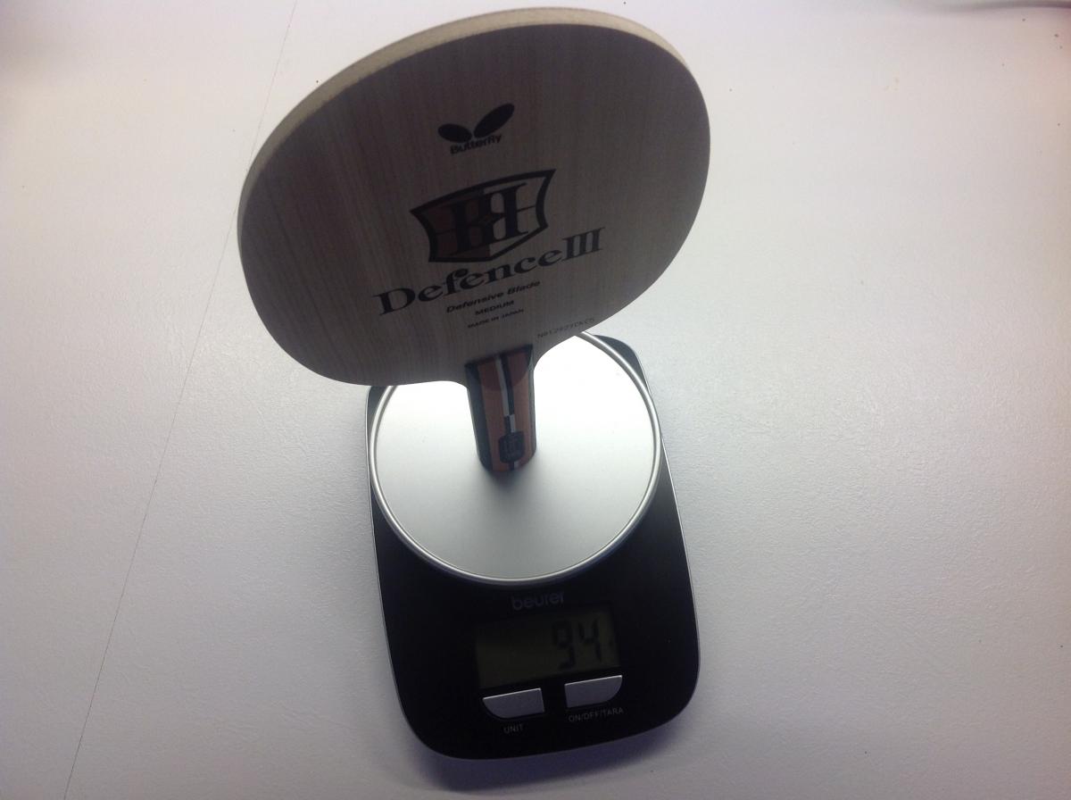

BeitragDi 23. Jul 2013, 10:06
94gr. :geil:
